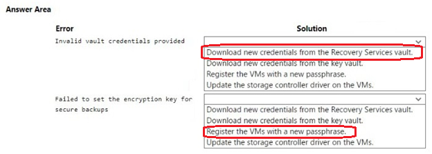

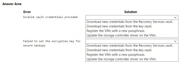

HOTSPOT
A company uses an Azure Backup agent to back up specific files and folders from an Azure virtual machine (VM) and an on-premises VM.
An administrator reports that the backup job fails on both VMs. Errors are returned in Microsoft Azure Recovery Services (MARS).
You need to troubleshoot the backup issues.
Which troubleshooting solution should you use? To answer, select the appropriate options in the answer area.

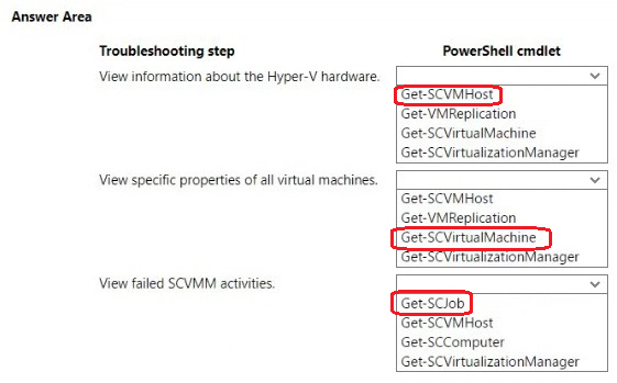

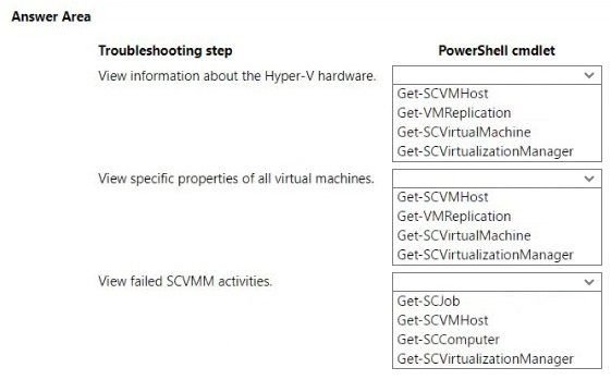

HOTSPOT
A company uses Azure Site Recovery for their on-premises Hyper-V servers. The company manages servers by using System Center Virtual Machine Manager (SCVMM).
An administrator reports that replication to the secondary site has failed.
You need to inspect the SCVMM logs and configuration files.
Which PowerShell cmdlets should you use? To answer, select the appropriate options in the answer area.

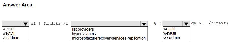

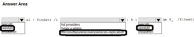

HOTSPOT
A company uses Azure Site Recovery for an on-premises server.
The company reports that replication of the server to Azure has failed.
You need to inspect the logs on the server to troubleshoot the issue.
How should you complete the command? To answer, select the appropriate options in the answer area.
