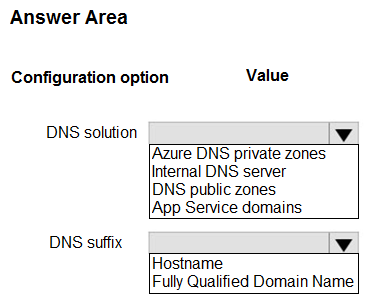

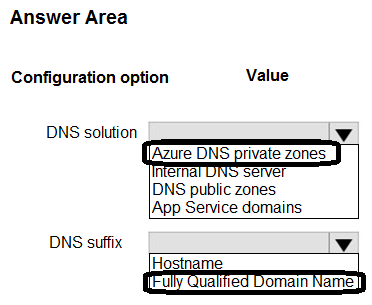

A company has an Azure environment that uses one virtual network.
The company restructures the environment to use two different virtual networks. Virtual machines in one network cannot communicate with virtual machines in the other virtual network.
You need to resolve the name resolution issue.
What should you use? To answer, select the appropriate options in the answer area.

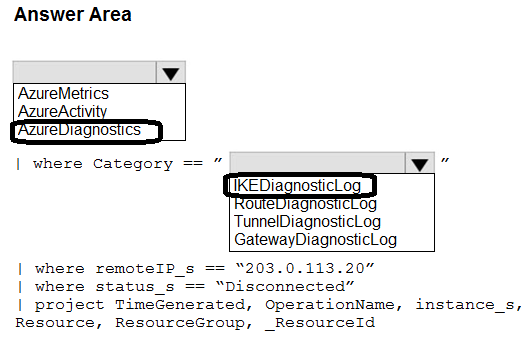

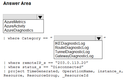

A company uses an Azure VPN gateway with an IP address of 208.0.113.20.
Users report that the VPN connection frequently drops.
You need to determine when each connection failure occurred.
How should you complete the Azure Monitor query? To answer, select the appropriate option in the answer area.
